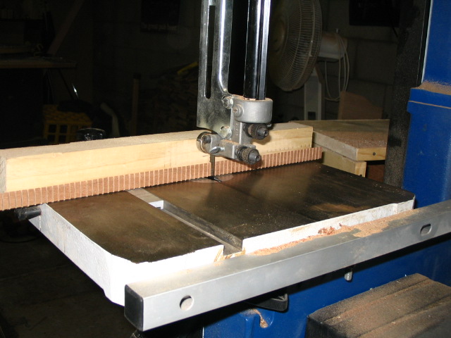

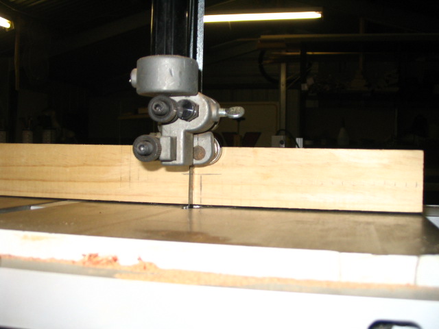

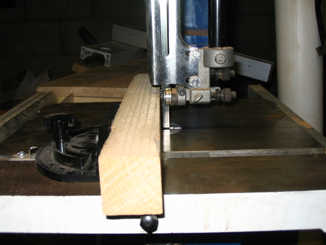

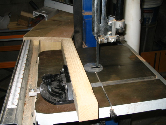

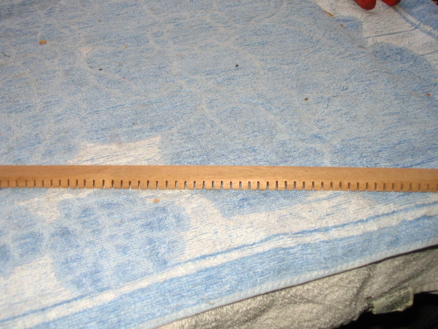

Here's a quick and dirty lining maker.
Construction time around 5 minutes.
Screw a lump of 1.5" x 1.5" scrap to your bandsaw guide.
Draw a line the width you'd like your kerfs.
Set the bandsaw so that the back and forward blade guides rest on the wood. Adjust it to set the kerf depth.
Move the lining so that the kerf aligns with the pencils mark.
Voila.

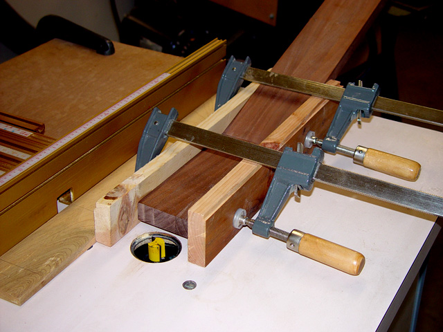

Here's my quick and easy fixture for holding a scarf jointed neck while rout-planing the face on a router table.
Ray
